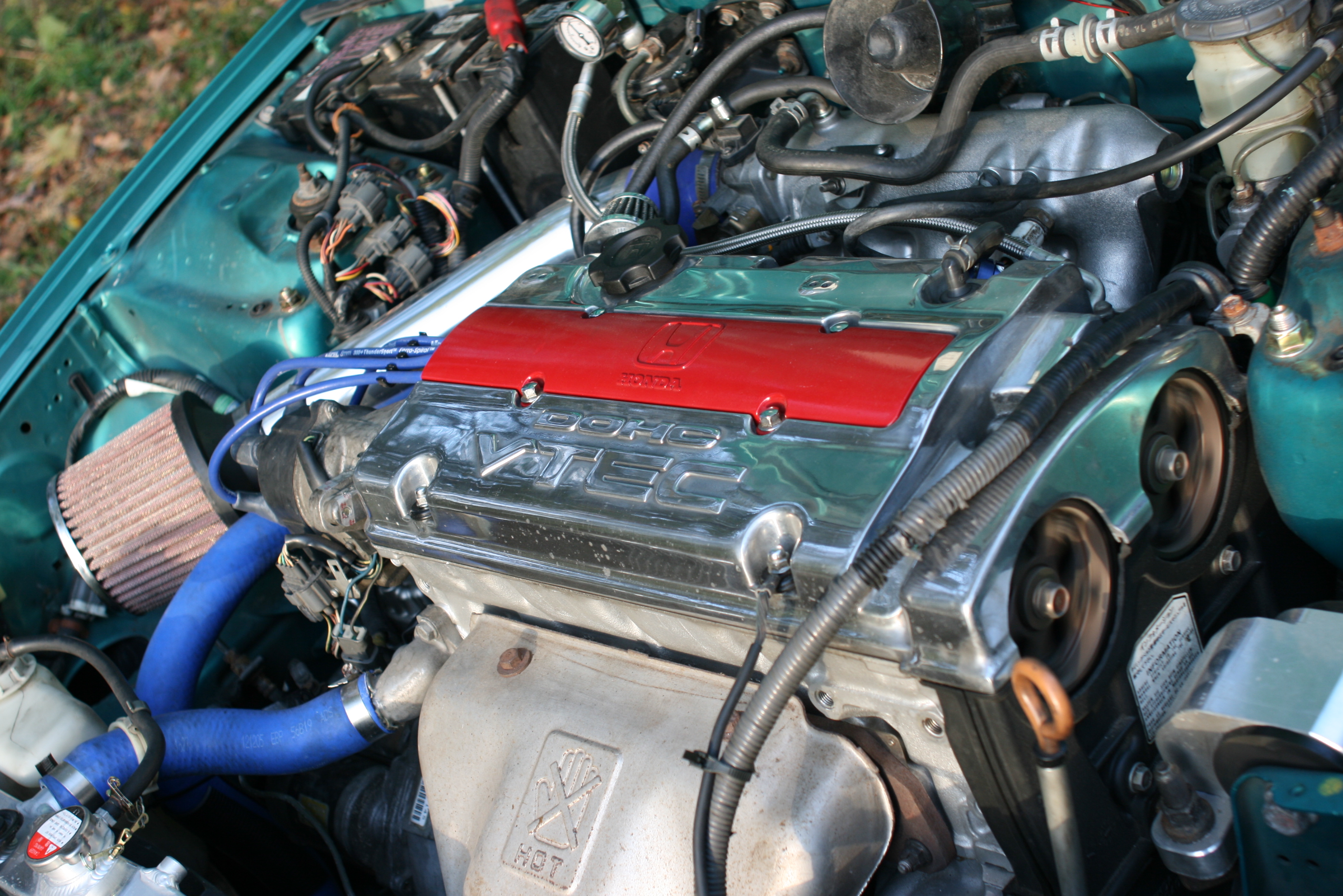

Linky no worky.
Tohle byl muj Civic, ani jsem ho nestacil prodat a pred par tydny mi ho ukradli.

pěkná barva Velmi šťastný

Ty kur... bych asi zastřelil. Krasacec jak cip. To musel být trhačVelmi šťastný

jaj, to potesi...jak to jelo v porovnani s preludkou? Na trati

Ani jsem nestacil upravit (diky bohu) suspension a gumy,takze na okruhu jsem s tim jeste nebyl. Ale WRX nemelo na silnici sanci.
Zde je muj maly setup z jednoho forumu:
93 Civic DX hatch 2.2 (210 whp 161ft-lbs of torque with stock header!)
H22 A1 build;
Kaizenspeed balancer shafts eliminator kit, type S pistons, Crower stage 2 cams, BDL cam gears, Supertech springs & Ti retainers, port, polish & skimed head, higher compression head gasket, Euro R manifold, heatshield gasket, Avid motor mounts, Exedy stage 2 clutch, Streetlight flywheel, M2Y4 tranny, alu. radiator, Gates racing radiator hoses, custom made axles, rebuild halfshaft, Apexi WS2 exhaust, B&M fuel pressure regulator, Accel ign. wires, machined crank pulley for single belt.
Tuned on Crome Pro.
Suspension;
Integra brakes all around, Integra booster, master cylinder and prop.valve, Integra lower control arms with hubs.
15'' Integra blades.
